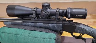

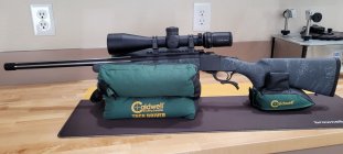

The plan was to start with the 17FB, then determine another 17 caliber.

Beautiful! I am a #1 fancier and typically like nice wood on them but you just changed my perspective on that. Who built your #1 Mike? Dibs if you ever sell ❤️

Who made your #1 stock ?
Looks great. How does it shoot?
Very nice job on the fit of the picatinny rail. Did you do the gunsmithing on that #1 ?
Hal
