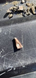

Just started having issues with the 6.5 ATips, after about 400 rounds of the 500 I bought the last box of 100 I started getting flyers and shots that never reached the target. Couldn’t figure out what was going on even after clean and checking every aspect of the rifle, as well as checking the load and what ever I could think of. I put a target up at 80 yards and that told the story, these bullets are deforming or just completely coming apart some of the bullet holes look like a Cheeto cheese puff went through and one just splattered. I talked with Hornady manufacturing tech and sent him some pictures, no response as of yet. Here are some pics, when the bullet held together it was not grouping consistently. Also found a complete half of a bullet with no lead in it that was just laying on the surface of a gravel mound a few yards behind the target. 53FB3C98-4456-489A-B6C4-AEA52CAB4BAF.jpeg8647C045-3834-4957-910C-0C25367598E4.jpeg238B3614-E9FF-4235-9BE1-77155D24D98E.jpeg
