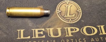

elite hunter leftover.jpgWell, it may not open. It will fragment and lead core can leave the game without transferring the expected energy. Below you will find the copper jacket of Elite Hunter that I pulled out of a deer last week. The lead core was gone. VLD is an open tip bullet just like Elite Hunter or Hybrid (just a different ogive). I hit the scapula blade and the bullet did not retain much weight as you might expect. My deer was shot at 120m.

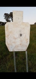

And as for accuracy this is 3 at 757 yards just saying some rifles will digest some impressive loads and mine is renowned for slow barrels but it isn't its the difference between a book load and a hand load .
