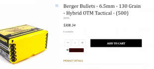

130 Berger otm hybrid ? 6.5
Can’t seem to find these rascals in stock. I had a great load worked up for them.
Anyone have a source for them or a similar projectile that is actually available ?

still available here:
