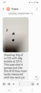

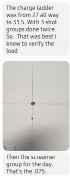

Treece groups with his 6bra 12 twist Urbanrifleman barrel.
