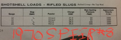

Unique's burn rate is to fast for Lee slugs, unless you want reduced loads. There is no data using plastic wads & Lee Key drive slug & Unique powder, that i know of? I worked up some Unique loads with 1 oz Lee Key Drive slugs. Acccuracy was poor. Pressure needs to be high enough to expand the slug to the bore.
Photo of 1999 Alliant data. View attachment 1217371
Thanks both of these are helpful.
