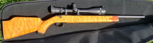

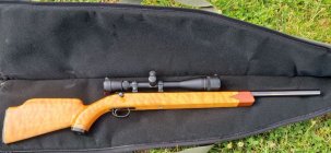

This one is built on a Remington 591 action that I converted to center fire and 22 Hornet bolt face with a Sako style extractor. I worked with Frank Brakefield " The Old Redneck" to get the project off the ground a long time back.
This was from Remington back in the day when these 12 caliber projects got started.
"The chamber and extraction system were specially designed to safely function with the high pressures generated by the 5mm cartridge (SAAMI specification called for 37,000 psi with a maximum product average of 42,900 psi, and a maximum proof pressure of 62,000 psi)."
