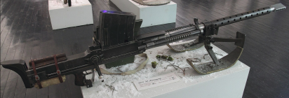

That's what I did my 12.7x114 on. A dewat Lahti. I did it in 50cal because then I didn't have to register it as a destructive device. The bolt face for the 20x138B Solothurn round is the same as the 14.5mm case. Even though the 12.7x114 round was shorter it fed from the magazine with no issues.
