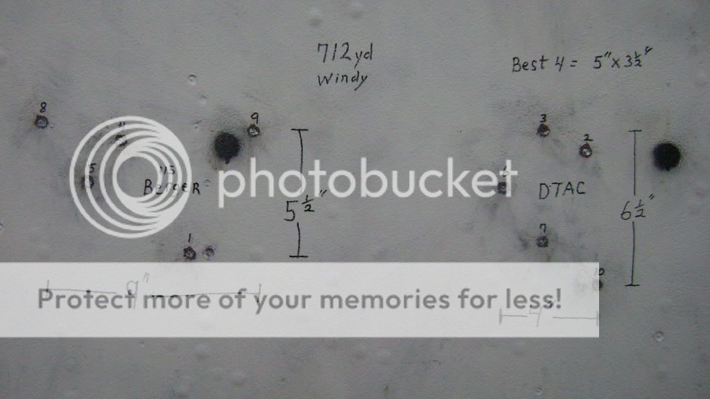

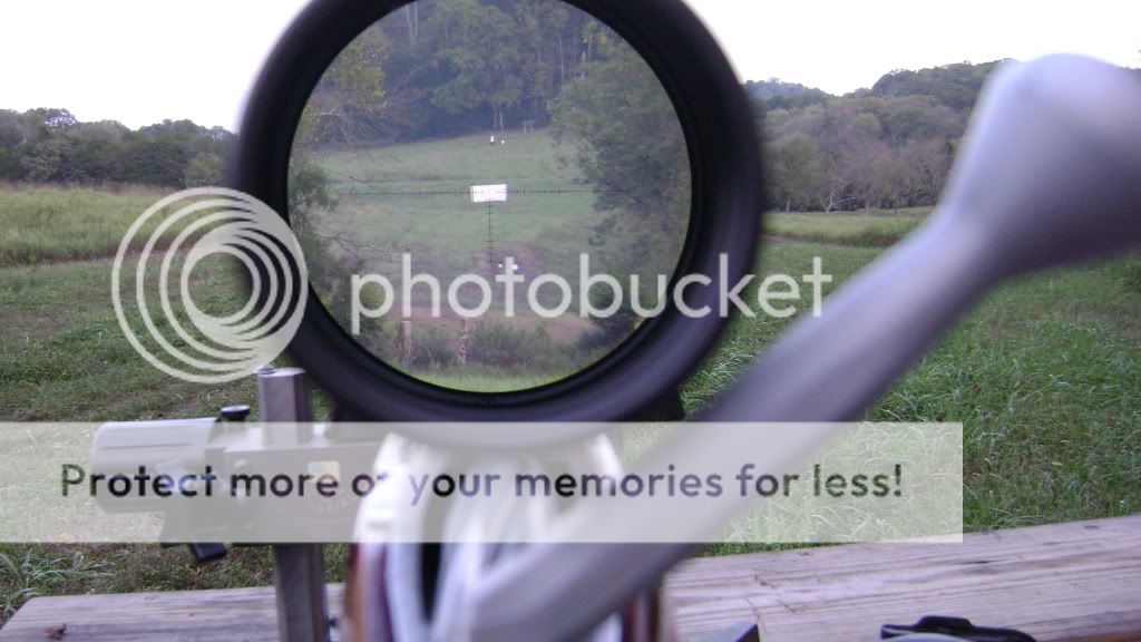

I had a twi-light range trip yesterday p.m. I shot the DTAC's
at 1,000 yd at a metal ground hog silhouette and a 18 in.
steel plate. I took 10 rounds and hit the ground hog 3 times
with the first 8 shots including a sighter. The 3 hits made a
4 in. group with 2 shots 1 in. apart.
I shot the last 2 shots at the plate and had a 2 in., two shot group.
I have done no load work-up for the DTAC at 100 yds. I just
set the bullet at the lands and went shooting.
Next project is to take test O.A.L. & powder charge at 100 yds.
