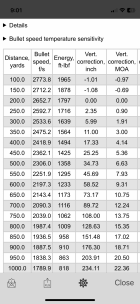

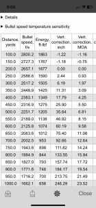

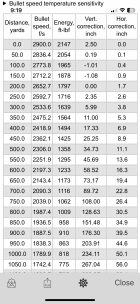

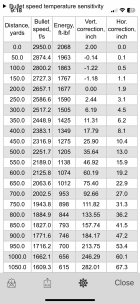

Very tricky wind today, tailwind at 45 degrees to range, 16 mph gusts. No cleans were shot by any of 10 shooters. I labeled the bullets in the saved name. The duo produced a 445-19X and the next highest score was a saum with 444-19X.
The DTACs won match 1 (by creedmoor), the A-Tips won match 2, and the A-Tips lost match 3 on x count, with a ship anchor 9, one on.
The brass pressure is about the same looking at primers and the velocity spread between the two is evident, and that’s based on both weight and BC.
Edit. After the post all targets were corrected to yards instead of meters and the final one to .243 cal., and nothing changed score wise on any of them.
