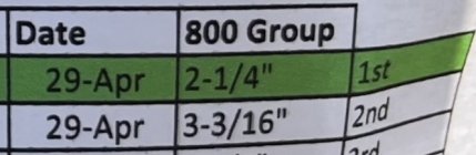

I am trying to find a stable competitive load for my 6 BRA with the 109 Bergers. I would love to hear people’s experiences. I tend to have 3 or 4 of the five-shot group nice and tight (1-1.5” at 600 yards) but almost always 1 or 2 fliers turning it into a 3-3.5” group. My barrel has shot well with other bullets. Do you think I just need to keep working at it to find a group that doesn’t produce fliers or should I just find a different bullet?
Barrel is a 4 groove 1:8 twist 29” straight contour (1.25” at the muzzle).
The 108 burgers averaged 2-2.5” five-shot groups pretty consistently evenly spread, but just couldn’t get it to go below 2”.
One guy at our club consistently posts 7-9” composites (averaging under 2” per 5-shot group).
Thoughts? I am mostly looking for those with real experience with 600 or 1000 yard benchrest and the 109 bergers.
