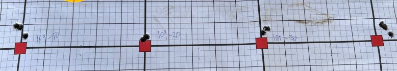

Always looking for an advantage, I noted the higher BC’s of the 109 Hybrid. I ordered 100 to play with and see what I can do with those. Using H4895, I can get them up to 2900fps but starting to see ejector shiny spot and edges of primers flattening out. 2850 did not show the pressure signs. The 8 shots I took with powder charges from 28.5-29.8gr all piled into similar POI in a 0.7moa group.

BUT- I also tried a series of N150 (yeah, a lot slower I know). I never got to 2800fps and had very rounded primers, so way under max pressure. BUT- these 8 shots all went into a 0.7 MOA horizontal row with the same elevation.
There is room in the case to go up to 31grains so I may try to get the 109’s up to 2850+ and see if that pattern holds, as well as test the 105’s with N150 and see how that vertical is. Cutting vertical in half is worth looking into with N150 and other slower powders.

Those images were of a range of powder charges. I need to shoot some larger sample size groups of the same charge and seating depth. I don expect it to walk across the paper with the same charge.
