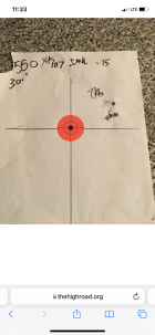

will check out the rifle and scope etc for anything obvious. I did scope the barrel and noticed these machining marks on the lands right at the end of the throat. Other than that, barrel looks good.
testing was at 100yds.View attachment 1324712View attachment 1324713
wow---i have lived a sheltered life---i have never seen a custom/aftermarket bbl that looked that ruff !!--is this a savage or budget item--if a bullet runs over that cheese shreder it is going to be streaking copper all the way down the bbl and the torn jacket will not allow the bullet to fly right (in my humble opinion )--I would not waste any more components on tht rototiller of a chamber --life is too short to spend time trying to make that disaster shoot--Roger

Seating depth appears to have worked.
Seated right at the lands shrunk the groups to under 1/2 moa. I can live with that
don’t think the barrel has an issue. Barrel maker offered to take it back. Told them I’d do seating depth test first. Also tried mag fed ammo (different bullet) and it shot really well.
My 6BR is just a simple Savage target action with a Shilen 28" 1-8 barrel in a savage f-class stock, I use 107 sierra 105 hybrid berger's and the 108 bergers with great success, Seated touching the lands with 30.0gr Varget for all loads. The gun shoots in the high 590's for 600 yard matches.
