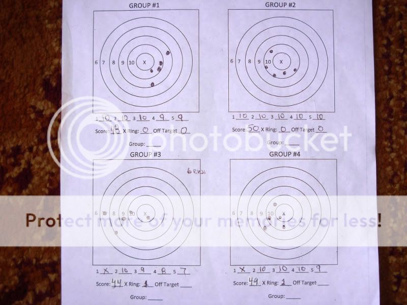

Running the numbers on Bryan Litz's ballistics program (using actual chrono data from my 6.5x47s & 308s), it's obvious that the little 6.5x47 would qualify as a contender at 1k. Compared to a 308 shooting even the newer 155 Palma bullets, a Berger 140 LR BT running 2824fps out of a 6.5x47 will hit 2.5 MOA inside a Sierra #2156 @2950fps out of a 308 at 1k in a 10mph full-value wind. In my book, that's not too shabby.
I've seen a lot of higher velocities claimed for the 6.5x47 here & on other sites, but accuracy at 2824fps out of my barrel has been considerably better than at 2900+.

So after comparing numerous real world fps for H4350 and QL, appears QL is within 25fps of actual
QL 41.5 6.5x47 140vld shows 2981fps so 2950 should be doable, 2900+ for sure.

It will get 2950 fps. no problem with a 31" bbl. and Reloader 17. My "47" is 28" and I run it at 2930 fps. It's also somewhat accurate! ;D
I have used mine at 1000 yds. and have shot in the mid to low 190's with my "47" pretty consistently, sometimes giving the "7's" a run for their money!
