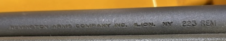

Something here may be amiss. Is the barrel stamped with the information like shown below (may appear differently):Screenshot 2024-06-29 at 8.03.31 AM.png
If it isn't then the barrel is not original to the rifle. If it is then it is strange that Remington didn't denote the twist on the barrel.
The potential issue here is the barrel may be chambered for something other than 223 Remington. The 222 Rem and 222 Rem Magnum both come to mind as they were standard 14 twist. If chambered in 222 Rem a 223 cartridge will not allow the bolt to close but a 222 Rem Mag will allow the the cartridge to chamber but may or may not fire. If it were to fire the case would likely fail and potential injury could result.
If this isn't an original factory barrel and you don't know the history of the rifle it would be a good idea to have a gunsmith check the camber with headspace gauges to verify the chambering.
Normally when Remington put a chambering out with the SAAMi spec twist (1 in 12 for 223 ) the twist is not marked on the barrel like the one in the photo. If they deviated they would mark the twist on the barrel, usually right next to the chambering,
