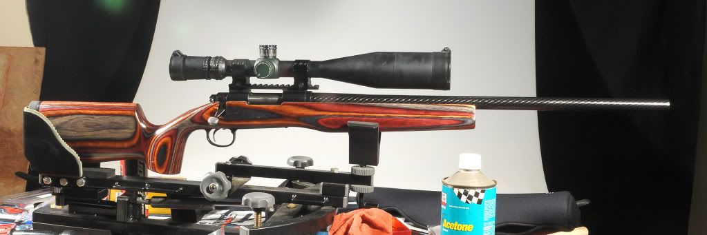

I have ended up with a savage sa .308 with a mcgowen mag contour 22" braked barrel in 1:12. My thoughts are mostly to play with this on the bench in the 300-600yd range. I have had good results in the past with the 155gr amax and smk's, however those barrels were 1:10's and 24-26".
What are your thoughts on what bullet weight to try in this just for fun rifle? Thanks, blue

I have two different stocks i'm waiting on to use with this rifle and neither of them are showing up, ... uggggh!
I'm about to pull one of my hunting rifles apart just to have a stock so i can start breaking this action/barrel combo in. blue

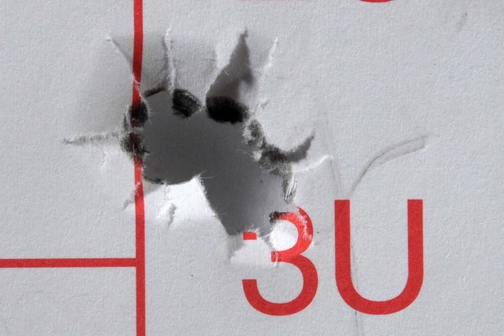

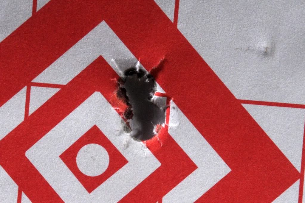

Just got my 308 1-12 Douglas barrel back and had some 178 AMAX from another gun and shot these two 3 shot groups with it
Shot at 100yds. I took it out to start breaking in the barrel..I took a box of 155 UMC cheap loads and shot and cleaned before I shoot these groups with 178AMAX with 44grns of varget .010 off lands. Only had 12 rounds loaded just to see what hand loads would do. These 2 are right at .25moa and the other 2 3shot groups were in the 3's. Not bad for a new gun and not much breakin. Will work up loads in 155 and 168 and tweak the 178's more. I'm very happy with this gun
My 1 in 12 seems to like the hornady 168 grain match bullets with varget,re-15 and 4895 the best. I shot a 3 shot at 200 yds today and it measured center to center in the high .2's. It is a bull barrel McGowen barrel. I am impressed.
