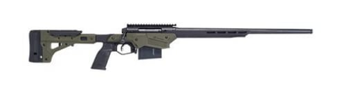

Do have a Savage Axis II Precision in 6.5 manbun that shoots to 1000 yds. It a MDT Chassis rig. Mine runs good. I have never tried it as a prone sling rifle. 22" 1/8 twist. Threaded barrel, accutrigger. Likes 140 ELDM
Very cost effective rifle, mlok forend for attachments. I run a Arca rail. Extra weights on forend and butt. 20MOA rail is already there.
Lots of people hitting MOA size steel at 1,000yds and beyond with this Axis II.
