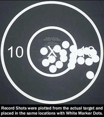

Look at Charles Ballard's record target here on the sight. If I'm seeing it correctly, his 284 held right at or slightly below 1/2 MOA.
If you are looking at this target:
There's no way that's less than 1/2 minute of vertical. Half a minute would mean that ALL the shots were in a string that is half the size of the X-ring or less, right? Unless this is an older F-Class target. If this is a modern (5" X) target, then my guess is that it's somewhere around 3/4 of minute vertical, maybe a bit less. There're two shots (ok, mostly one shot) that take it out of the 1/2 minute race. Damn good shooting overall though. Wish I shot like that.
EDIT: Do'h! David is right, I am wrong. He is the best, I am the worst. He is very good looking, I am not very attractive... ;D

Jay,
The X ring is 1/2 MOA. I think David is about right.
