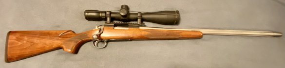

About the Remington factory barrels, this one was a new .223 take off from the gun show, screwed onto an old 722 action. And that 26.5gr load is the one I've settled on, haven't tried other bullets or powder. Easiest accuracy I've ever found. Don't sell the Remington short.IMG_1389.jpeg

About the Remington factory barrels, this one was a new .223 take off from the gun show, screwed onto an old 722 action. And that 26.5gr load is the one I've settled on, haven't tried other bullets or powder. Easiest accuracy I've ever found. Don't sell the Remington short.View attachment 1705537
Pretty rifle. Why oh why did Remington change to the current bolt handle?
Remington didn't change the handle. That's a modified 722 bolt done by some former owner. The rifle was an otherwise factory 722/222 from a pawnshop back in the 1990's. I really like that bolt handle, feels perfect. I notched the tang like a 700 for a 700 safety, installed a 700 trigger and now it's a 700, Fits 700 stocks without opening up for a 722 safety.
Yes, that bolt handle is just classy. I should have said that Remington should have changed the bolt handle. Pretty work.
