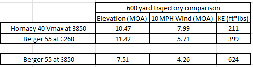

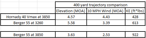

Here is a comparison of the typical energy levels with the 20 cal 40 VMax compared to a 55 Berger at 600 and 400 yards.
G7 BC Berger 55 Varmint BT = 0.182
G7 BC Honrady 40 VMax = 0.116
