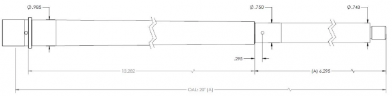

I'm not finding an off the shelf barrel in the configuration I am looking for. 20" Bull barrel, .750" rifle gas, 6mm, 8 twist, not threaded. The cartridge will be 6 ARC
Proof research comes closest. It is threaded, I could probably live with that. It is 7.5 twist, I could probably live with that. But the gas length is spec'd as "Rifle +1", whatever that is. I am planning on using a piston so getting a push rod of the correct length is a complication.
The goal is to build a 1/2 MOA rifle to shoot a local match, 300 yard AR Varmint Benchrest.
I'm looking for someone to take a Kreiger or Bartlein blank and carve it into a properly profiled AR-15 barrel.
This profile would work, delete the threaded end and locate the gas block at standard rifle length, whatever that is. Straight 1" to the gas block feature would be fine too, preferred actually. Wouldn't need to be chambered either. I have someone here that will chamber it for me. Off the shelf extension and bolt.

Not according to Shilen;
We can sell a turned (contoured) blank or untured barrel blank which would have a 1.25" outside diameter.
For the AR15 6ARC
the 20" barrel would be the service rifle contour:
6 ARC​
S/S​
Service Rifle​
7​
6​
20​
.725​
.750​
A15-016-SRS-S​
$550.00​
the heaviest is a 24"
6 ARC​
S/S​
Heavy Varmint​
7​
6​
24​
.920​
.936​
A15-017-HVL-S​
$550.00​
