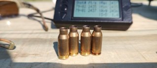

Ok so the last two days have been a bit of a cluster with this lil guy, and I have to be some sort of crazy because I've been enjoying the process.....now the process includes me wanting to ram my head though the wall but haaaayy. So sorry if this is a bit rambling and random
So, to skip over a lot of extra stuff ,long story short my home made brass has been the main problem . And I gotta say , I feel a bit stupid because I've NEVER messed with neck turning and all that so this is a new deal for me. Now the main problem I've been having over a good no ejection. This lil guy is actually a great shooter ( for the whole 50yd I've been shooting)

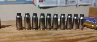

Along with some BEAUTIFUL case forming ... For the most part

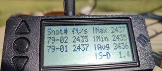

Also was able some wild velocities from this lil 8.5" barrel

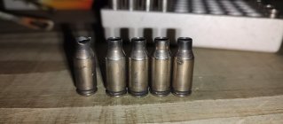

Well still no ejection at this point I dropped dback down to a mid level load and said I wanna see what would happen if I trimmed the buffer spring. I know this is something 9mm blow back and suppressed guys will do at times , and a new spring is like $20 so why not. So popped off a coil and GOT AN EJECTION!
......that end up being a case head separation lol. Lil paper towel, some cero safe and a cleaning rod and poof
First one I've ever had sooooo was a fun l problem solving deal.

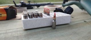

Well there was some fairy ammo just sitting on the kitchen table and I was just like " why not " grabbing them , loaded them and boom boom boom perfect cycling into the dirt!
So at this point I'm at my wits end I've done everything..... except try to reload the factory brass. So said screw it , when in side found a few , resized and loaded them with one of the most mild loads I had ( like 10.0 GR of lil gun I think) and I'm honestly not expecting much aaannnd boom boom boom CYCLING AND LOCK BACK !
was it the necks being too thick ? Was it the coating this brass apparently has. ? Idk but it works ! So went to down and grabbed 2 50rd boxes .

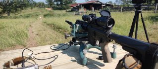

Spent the last hour shooting this stuff though the gun with different combos of buffer tubes and springs ( always used the KAK blue top weight) and THE THING JUST WORKED REGARDLESS!
And I've been horrible keeping track of everything between doing chores and what not and can't quite remember if this was with th pistol or carbine buffer tube but the forms are interesting.

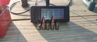

This group is from using the KAK spring and weight
And with a standard sling and the KAK weight
So... Feeling like the KAK spring ( even though it's not missing a coil and a half) and weight is the best for the casings...but man if I just wanted this thing to run I think I'd go with the standar and the weight
