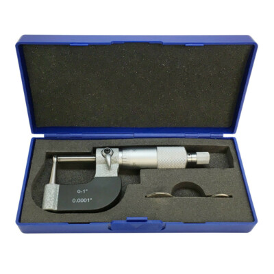

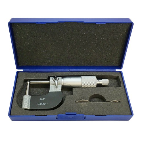

I bought a mitutoyo micrometer for measure the od of my cases that I'm turning. I turned bout 20 cases last year to get ready fire form them.
My chamber is a .269 and my loaded rounds are .267.
Now I had received 9 pieces of brass from a gentlemen who reamed my barrel for me and is also a avid competitor.
Now I measured the o.d of the brass he turned and I tried to get as close as I could to his numbers. Even though i did that my loaded rounds are still .267 instead of .266.
I used the smallest bushing that I had when I fl sized the cases which was the .264.
Now do I buy a ball micrometer to get the right dimensions of the turned case or buy a .263, .262 bushing so my loaded round would .266

A ball mic probably wont help you because it is too big to fit inside the case necks. You need a pin mic to do what you are wanting to do. Also, if we get caught using digital mics or calipers to measure production parts at work, we get 3 days off without pay....

Gage pins would help you with measuring the ID, they're cheap. Lots of articles around on those to help you decide what to buy there, the come in plus or minus sizes, may want both for your purposes. Check to see if your bushing really is 264 or not, get a 263 if you need to. Neck hardness can affect springback if not annealed.

Buy a Mitutyo Uni Mike...you can use a piece of drill rod or Dowell pin ...of a size that fit into the case mouth easily as the bottom anvil to accurately measure your wall thickness. Hint retired machinist and its what I use to check, out wall of roundness, wall taper, and wall thickness.

If I'm reading this right, it seems like the OP is trying to make the OD of a loaded round smaller with bushings? Ain't gonna happen. Yes, a tubing mic is a really good tool to have for neck turning.

This micrometer was such a great investment. I don’t see a more accurate way.
