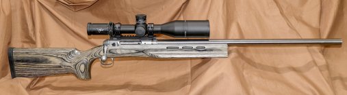

I have simply given up trying to find a subhalf-minute load for the 6XC after spending hundred$ sending about a thousand rounds thru the new barrel...SO...I'm starting over with a new bullet diameter, .257", and a new caliber, the Winchester Super Short Magnum.. I've always liked 25s, and my first real rifle, about 50 years ago, was a '98-Mauser (commercial SantaBarbara action)-based .25-284 with a Douglas 26" barrel. Sold that a million years ago; I wonder where it is?
My intention is to keep my Savage 12BR...

...which will need a new bolt and barrel.. This decision is just a day old, and I have Winchester brass, Hornady 117g. bullets, Forster dies, and ammo boxes ordered, and bought my first K of large-rifle primers (CCI 34s) in decades this morning @ Bruno's.. Have ordered the backordered Blackjack 131s and will get the Berger LR Hybrid 135s from Bruno's..
Haven't decided on a barrel; a 28" Savage-large-shank Shillen is 2 to 3 months away thru Northland, and I've contacted Blake Barrel and Rifle here in Phoenix to see what they can do.
