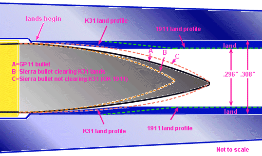

Yep, the hole in tool is not the exact same diameter as the ogive on the bullet. if you could measure "exactly" on the ogive the readings would be the same for all bullets for that chamber. Since its not the same diameter as the ogive, that relative diameter can be different distances from the actual ogive depending on the bullet shape.
This isnt exactly what the image is pointing out but its still illustrative.
You can see that the different orange lines are different bullet profiles and that the blue and green are different lands. Different combos of one or the other or both can lead to different results.
The bullets parabolic curve and the lands linear angle arent all the same.

On a slightly different topic. It would be advantageous to have an insert that was cut with the same reamer as your chamber. Then it would contact the bullet at the same place as the chamber would.
For you to better understand this, use your test case and bullet. Color the bullet with a marker so you can see where the lands touch the bullet. Remove the case and slide your comparator over the bullet. You will see that where it meets the bullet does no coincide with where the lands met the bullet.
