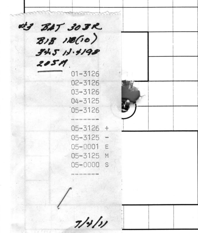

I believe it does when it comes to quality of my handloads. When I was using the Chargemaster alone I was satisfied with ES around 10 fps and thought that was as good as it gets. The FX-120I added to my loading process made a big difference. Whether the difference shows up on paper is still debatable but I'm confident that when one shot doesn't go where the others did, powder charge wasn't the reason.
My highest extreme spread for ten five shot groups shot the same day was 7 fps. This was the lowest:
