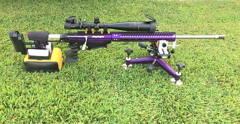

I'm shooting an RPR in 6.5 CM. Yes, I know...lol... It has a Patriot Valley Arms 26" barrel. Josh at PVA is making a thread protector for me so I can remove the Mad Scientist brake. I've added a Seekins hand rail and ambi safety, Timney trigger, AD Custom Rifles fluted the bolt and I added a titanium shroud and bolt handle along with a stainless bolt. The butt stock has a V-Tab adjustable butt plate and Wiebad check rest pad. Glass is a currently a Vortex Gen I PST 6-24x50 but I have a Golden Eagle on layaway at my LGS.
The RPR is shooting .3 MOA @ 100 with factory Fed American Eagle 140's. Successfully shooting out to 1140 yards on the range but all steel there so no clue if any of that will actually translate well in a match but I'm committed to practicing as much as I can and starting to shoot some matches in 2018. My intention is to compete against myself with learning and improving as the primary goals.
I work in a body shop and have pretty much custom painted all my stuff for many years. Colors of choice are House of Kolor PBC-65 Passion Purple and black covered with Cerakote MC-161 matte clear.

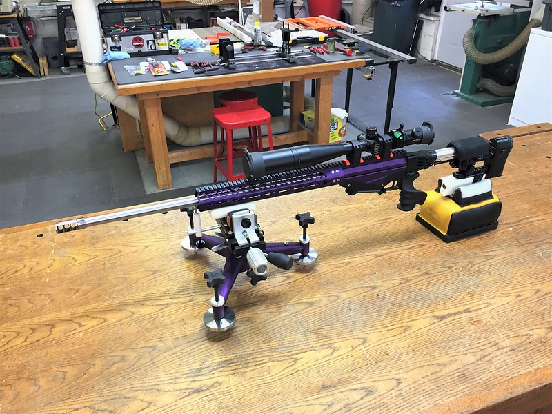

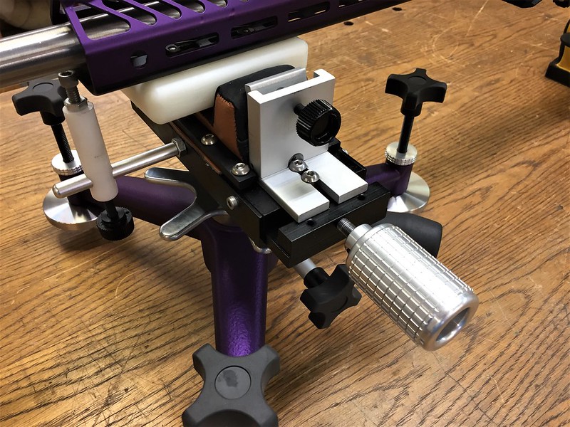

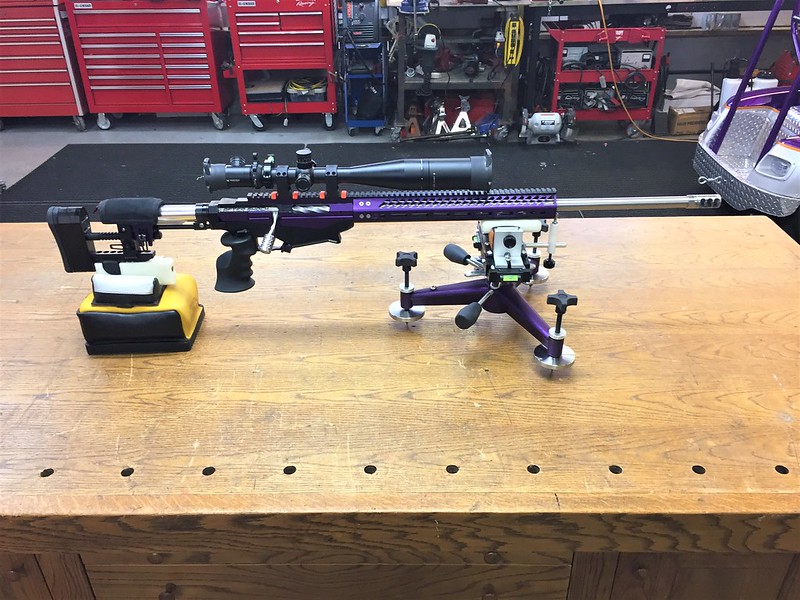

Recently bought a BE rest and did the windage knob mod, added the stainless F Class feet and longer adjusters. I also changed the hardware to all stainless and added a couple of levels. I'm using the Protektor Dr. rear bad with 1" ear spacing. Immediately I realized that the butt stock wasn't going to cut it on the rear bag and even though I got the 2 1/4" front bag and the Seekins rail is 2" wide and flat that it wasn't as stable or smooth as I'd like.
Here's the setup...

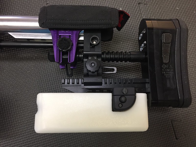

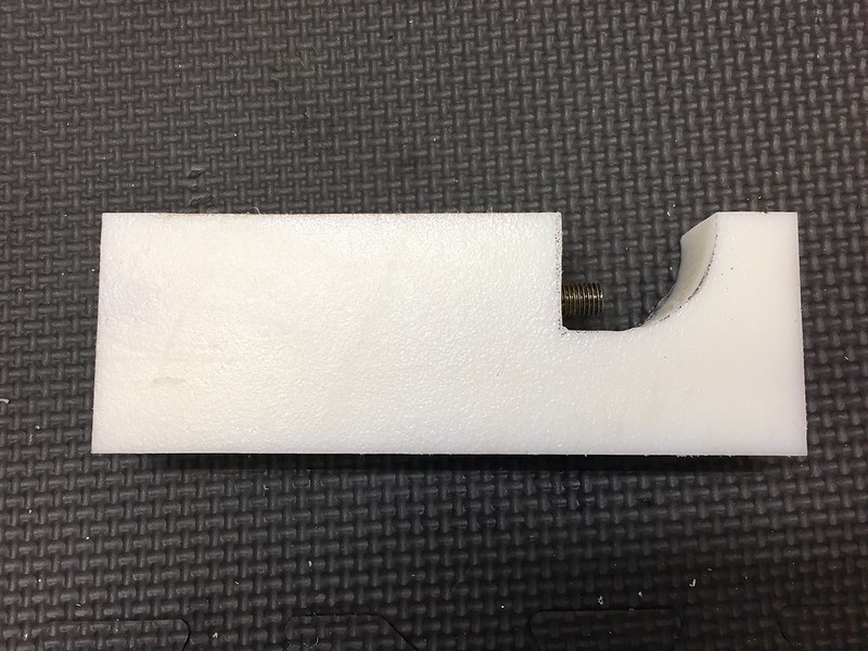

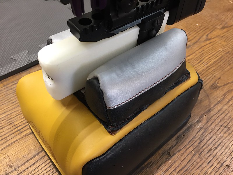

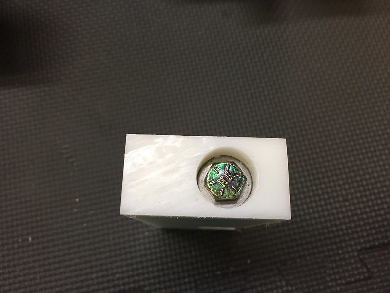

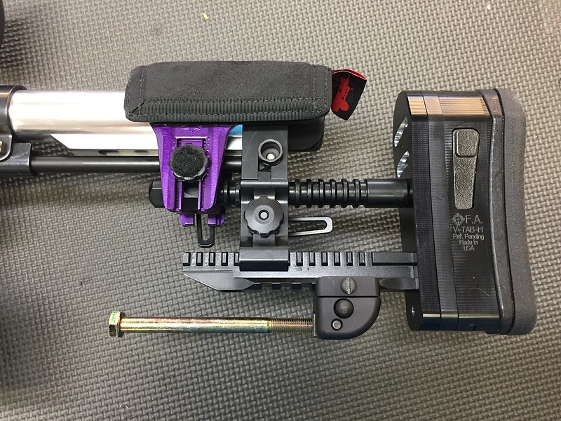

I decided that I'd attempt to make a set of bag riders. I have some HDPE 1" material and a pretty well equipped shop. I'd much rather make something vs buying it if at all possible. For the rear bag rider I disassembled my Accu-Shot monopod and used only the base. 4" 5/16x24 bolt will attach the rider to the monopod base.
Milled a piece of 2"x6"x1" HDPE to fit tight against the bottom of the butt stock and fit around the base. Drilled the appropriate holes for the bolt and to countersink the head.
A trip through the router table to round over the edges and some finish sanding completes the rear.

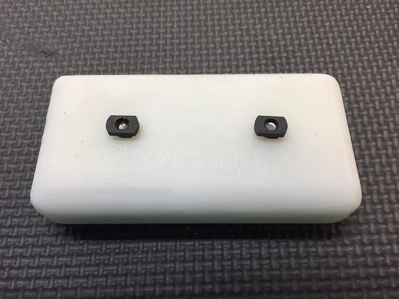

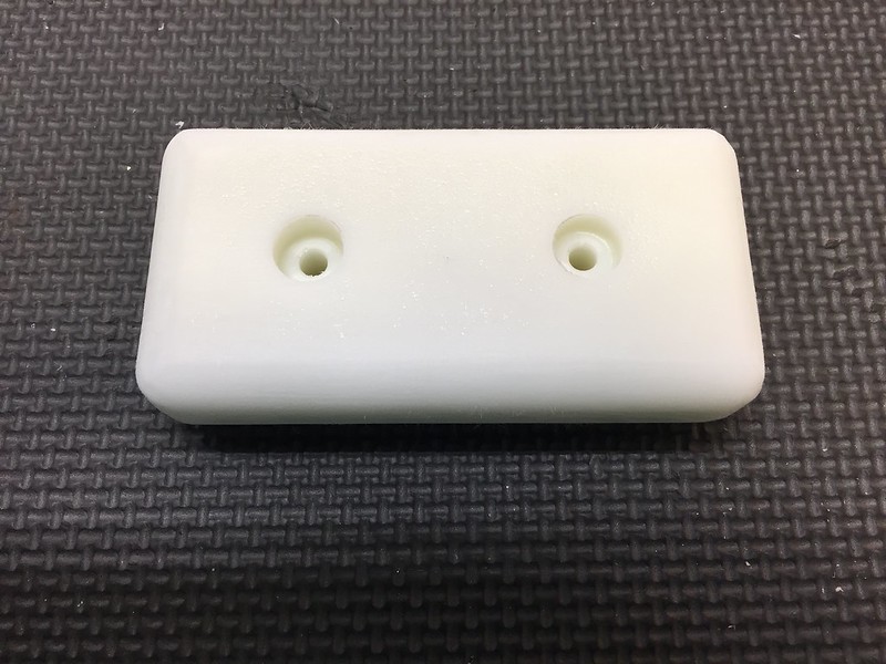

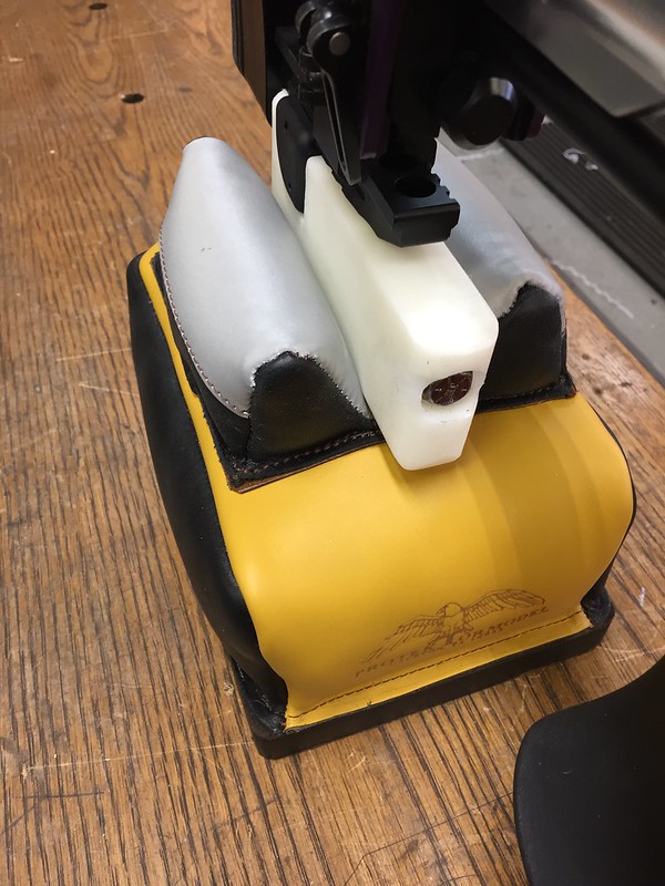

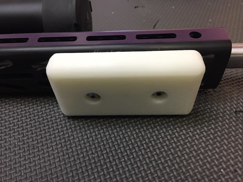

The front is super simple. Just a 2 1/4"x4 1/2"x1" HDPE with all the edges rounded over. I countersunk holes for a couple of 1" stainless screws for M-Lok fasteners to attach it to the rail. Kinda looks like bar of soap. lol...
I'm pretty pleased with how they came out. Seems like they will do the job.

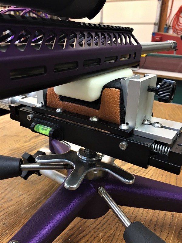

Nice work! One thing to consider - you may want to mill out the center of your front bag rider a depth 3/16" or so, leaving 1/4" thick raised edges on each side. This will help your tracking. Nice looking rig you got there! .3 MOA with factory ammo should be quite competitive. Go get 'em.

Thanks for the insight. I decided that I'd get a 3" bag and mill a new front rider. I'm going to recess the center to fit around the hand guard and I'll mill a recess on the bottom of that one.
Forum Boss: Yep -- you can go out to 3" wide for F-Open. I bet your system works great now, but you'll be surprised with the extra stabilty of 3".

Good choice. A wider bag/rider set up will help with torque, too. A 6.5 CM won't torque like a 6.5-284, but every little bit helps.

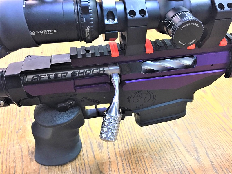

Very nice setup - and the 6.5 CM seems a good choice for any shooting out to and including 1000 yds. I can't make them out in your pictures so can you tell me what the orange things are on either side of your scope rings?
Ken
Ken
Hi Ken. Thanks! Those are index clips from LaRue Tactical. Their design intent is to mark the position of the scope rings so the scope can be easily reattached in the same position it was in if one had to remove it but quite honestly I mostly just like the pop of color.
