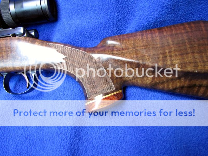

I have two Richards Microfit stocks. One was their highest grade walnut and one is a laminated called Coral.
The fit of the actions was good but both needed some fitting. The finishing aside from the sanding to smooth is a matter of how good do you want it to be. A serviceable finish can be had in a few hours. Mine took a LOT longer because I wanted a far better finish. They were both worth the price I paid and IMHO, they both are what I wanted with the fine finish I wanted and was willing to work for.
