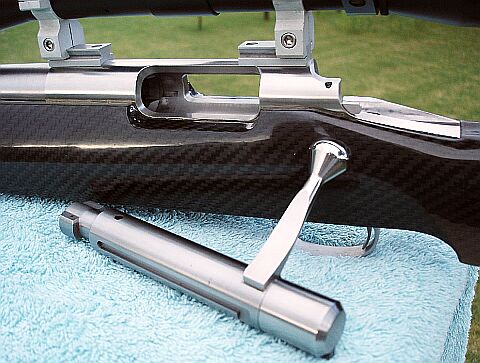

Don't be dismayed. Halls can look very nice. Allan just needs a better photographer. Here's one of his 'B' centerfire actions in high-polish, made originally for Dwight Scott.
And we've always said "handsome is as handsome does". You can't buy a better rimfire action. The Hall is what we've chosen for a new 17 HM2 rimfire project gun that, hopefully, will be ready by the end of summer.
What you say, rimfire on 6mmBR.com? Well, there will be a few more surprises in the months to come. Precision will still be the watchword but we'll be exploring some new territory both big and small.
