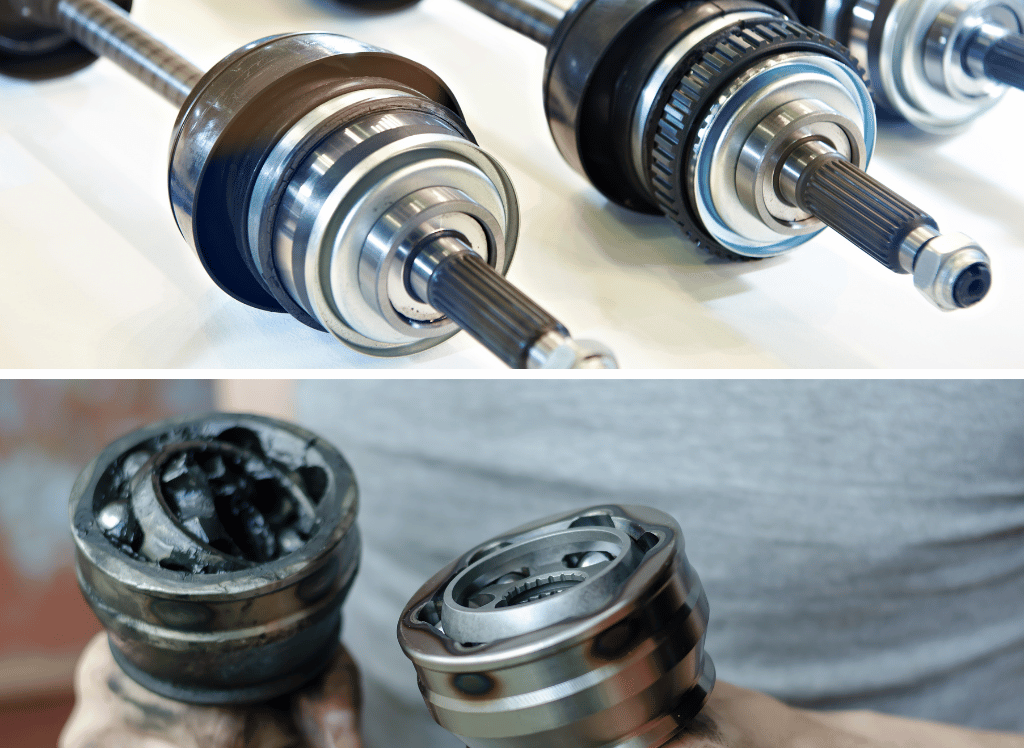

While at the local bike shack getting a CV shaft fixed on my ATV i came upon something. The bag of grease for any ATV joint is like pudding and I read the bag before the guy used it. I was seeing that stuff has a melting point of 750* and it stays where you put it and it has molly and a lot of graphite in it as well. If it has to take care of lubing a cv joint with those ball bearings at high speed and has all the great lube qualities it seams to me it must be the greatest grease for a gun of any kind. And might be great in auto rifles and pistols. Buy a bag of that grease and try it I am from now on an AR would do well with that lube.

Go ask for CV joint grease at any auto parts store. I work at one part time and we sell it. Hard to beat moly fortified wheel bearing grease but here is some specific you can ask for. Most just comes in a little foil pack except Redline. Most common will be PTC and dorman in your big box stores (of which I've worked 24 years)
Brands:
PTC
Redline (expensive but probably highest quality)
Sta-lube
Dorman
Napa
An extreme pressure grease with lithium and molybdenum.
