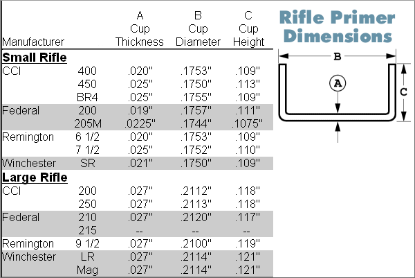

I have found spec's that says the Remington Small rifle primers are .110 depth. It sounds like you would want a Primer pocket Depth of .118 possible a little more.
I measured the Rem primers in 3 different cartons I have on hand (and 3 different lots bought months apart) all to be .122" tall. (And that was using both a digital, and a manual caliper..... so the problem is not faulty caliper readings.)
I don't know where the specs you found are coming from, but they are certainly at odds with my actual measurements I'm getting. Perhaps with the anvil removed they might measure. 110"

I took it from some spec's I found online as I don't have any Remington 7 1/2's.
It appears it's to the bottom of the Cup.
How deep is your primer pocket unformers cutting the pockets?
Foxguy, I just measured the primer cup WITHOUT THE ANVIL, and sure enough it measures the .110" that you indicated from your source. But the primer is a full .122" tall with the anvil included. All my small rifle primers I've seen have an anvil protruding beyond the cup which increases the height. (At least all the different primers I own, do) A primer is not sold without the anvil and does not function without the anvil, so what good is it for that that source to have provided a measurement without the anvil and NOT at least reference and/or mention the anvil? No need for you to say your sorry to me, as it's not your fault that the source is incomplete & confusing. We get this same sought of thing with what we hear between Fox & CNN News sources and often have to come to our own conclusions what may or may not be half truths. (not that I give CNN 5 seconds of viewing day) LOL. I appreciate you taking the time.
