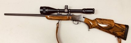

*The 222R is a cartridge invented by the Aussies for use in rebarreled Cadet Martini Action with a bushed firing pin, uses 222 dies and a 38 Spl shell holder, straight 222 loads, very accurate little Martini. Bass is available in Australia.

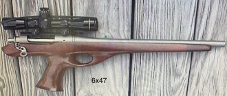

*The 6x47 is a necked up 222Mag, very accurate, barrel and brass lasts a long time. Dies are not difficult to come by. Almost any bullet or powder shoots in it.

I think these phots are labeled, the left is the 222R
