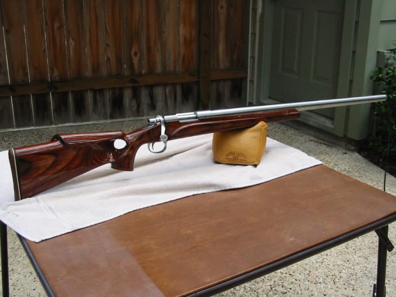

Wow, nice gun!

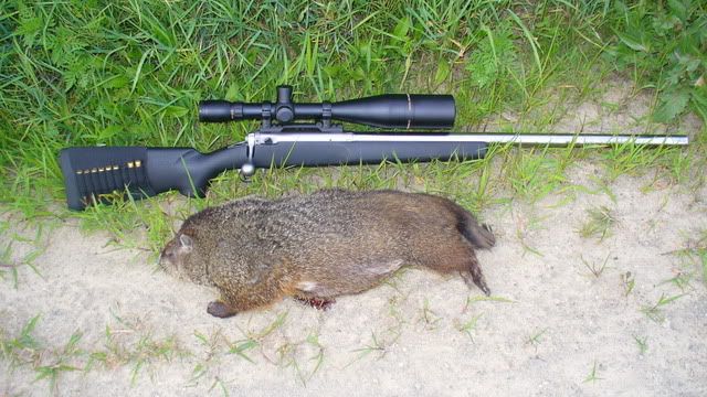

I've been shooting the 75 & 80gr Amax from a 22-250AI with a 8 twist and pushing the 75 Amax around 3300 with H-4831sc and loading the 80gr Amax with RL22,if you want the exact loads you can pm me) but do not have any velocity figures as my Pact chrono just quit on me. I have shot about a dozen groundhogs with the 75 Amax with very good results but only 2 with the 80's so far but it seems like the 75's expand better both hogs shot with the 80's one at over 450 yrds and one at 200 both had very small exit holes. One hog I shot with the 75 had no exit hole I could find, it was crawling towards me around 200 yrds and I shot it head on length wise through the body. Some of the hogs hit with the 75gr Amax at longer ranges seemed to have more damage than the closer shots, maybe the bullet didn't have time to expand fully, I am going to try the 75's in my 223AI and see how they perform on hogs. The 75gr Amax and H-4831sc load shoots so good in my 22-250 AI that I bought enough of both powder and bullets to outlast this barrel.

This is a smithed Remington VSSF 700 action with a glass bedded 29' four-groove Bartlein Barrel with a .910' muzzle. It's a Richards Micro stock that I refinished and loaded up with an extra 1 3/4 lbs of lead. Total weight with an 8x32 Black Diamond scope is 16 1/4 lbs. The reamer has minimal free-bore and a non turn .254 neck.
Weather permitting, hopefully I'll make it to the range tomorrow. It's the first time I'm using the new Burris too. I'm hoping as I do barrel break-in, all this new stuff will come togther for me with sub 1/2' groups. We'll see.
