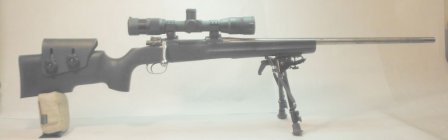

I have been working on Turkish Mausers for 20 years.
I am going to hunt with one in October. It is 260 Rem throated 3.1" OAL repeater.
I have converted turks to 45acp single shot, 223 single shot, 7.62x25mm single shot 308 repeater, 7.62x39mm single shot, 243 repeater, 25/35 single shot and 7x57mm repeater.

Add to your list , mine is 30/30 , 44 mag , 444 marlin , more after coffee and my memory starts working.
Yes Turk mausers were / are very capable and strong enough for most hunting cartridges , even the 300 weatherby . The small ring threads do limit the cartridge size and pressure.

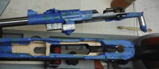

A lot more bedding block than a 6mmRem needed in this Turk.
