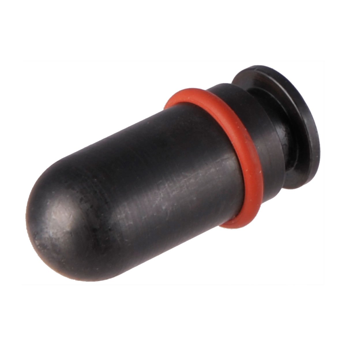

When u guys run a wet patch after your last shot at the range....
Couple of questions:
1) what solvent are you using?
2) do you bring a full rod to the range, or do you have some sort of travel setup? If so, would you mind sharing?
3) do you plug the chamber and bore so the solvent doesn't leak everywhere? If so, with what?
These three-ish questions are what have been stopping me from doing this at the range. And then I get busy with life and it's days until I get back to the rifle for cleaning.
I'm thinking one of those Otis type kits or weed Wacker patch pull lines might be the ticket for a non rod travel setup.
Full length Tipton rod, boreguide, patches, jag,. My solvent of choice is Bore Tech C4 and Hoppes 9 50/50 mix. No plug, however when applied with the boreguide in place I have the butt of the rifle elevated. When it goes in my drag bag it pretty much sits with muzzle down and the drag bag is placed on my rear truck seat, so the position remains the same for the ride home and continues that way until it makes it to the bench. It gets a proper cleaning with the muzzle down and boreguide in place. No chamber plug, nothing on the muzzle.
