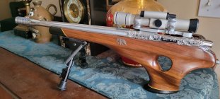

I’d go with a Lilja XP barrel from @Hoodoo
He sent me my barrel for my XP build.
@boltfluter fluted the bolt and barrel for me
I chambered it on my PM1236T in 6MM Creedmoor
Here’s a picture of mine on a recent doe hunt.
My barrel is an XP8 contour cut to 14”
I have that Leupold scope for sale too if you’re needing one it’s a VX3 2.5-8x32 handgun scope.
Barrels are roughly $320-375 any MFG
Chambering is going to be a
Between $250-350 depending on who’s doing the work
Open the BF up and add Sako Extractor is going to be around $150-200
Hope this helps. Those XP’s are a handful of fun!

Wow WSMNUT that is almost exactly the pitcher iv had in my head of what I'm looking for or to have built
