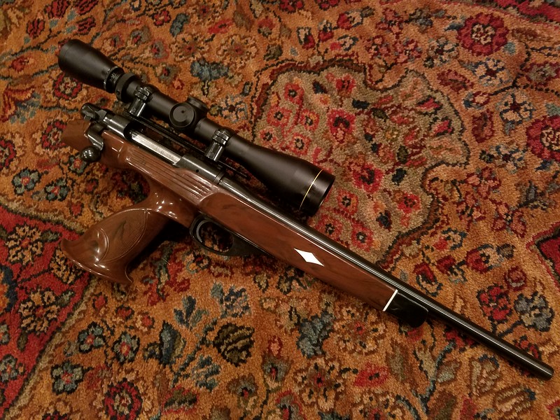

1986 Varminter with less than 200 rds through it. ;)
AR Pistols got nothing on XP-100's. :cool:
