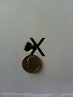

Best 6BR load for my Stiller Viper SS with 30" Bartlein 5R 8" twist:
WARNING--MOLY Load--Reduce for naked bullets
Lapua case, 38.9 g H2O
CCI 450
Sierra 107 MK moly, seated 2.380, -.010
31.1 8208 XBR for ~2930
Last chrono on a breezy 75° day:
Max Min Mean ES SD
2935.80 2925.90 2930.10 9.90 4.65
This load has produced several groups between .100 and .125 at 100. It groups pretty well at 300 provided the wind leaves me alone.
As our Forum Boss noted above, this load uses moly bullets, which produce less starting and peak pressure than naked bullets. My action is a very stiff Stiller Viper SS Drop Port with no ejector. The bolt has a very small firing pin diameter and the CCI 450 primers are hard. The short answer is to reduce the given load by 10% and work up in 1% increments, watching for pressure signs. Thanks for the reminder.
