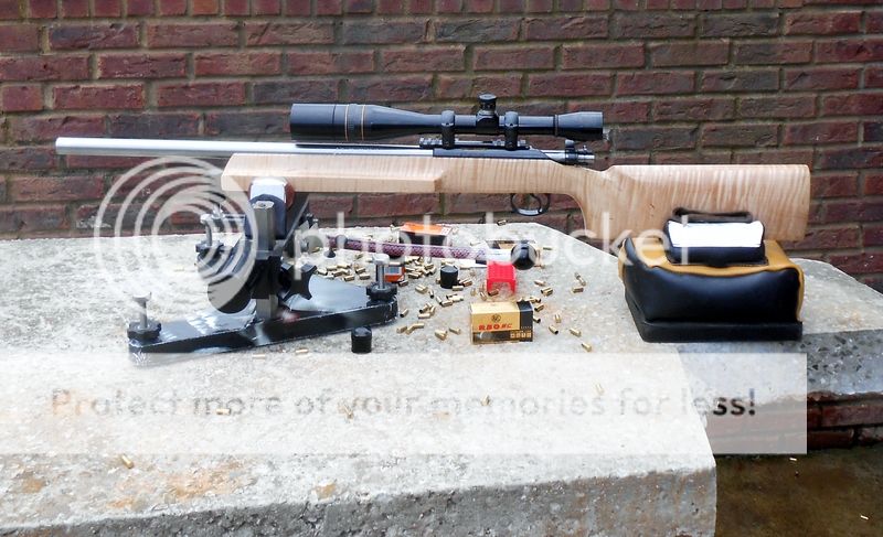

I did all my 455 myself,,got a Lilja bbl and a DIP adjustable sear and put a very light spring in the trigger that is very clean and 6-7 ounces,,got a maple 3 inch stock inletted by Don Stith and pillar bedded and finished it myself and it shoots very very well at 50 and 100 yards,,I probably could have bought a better rifle for what I wound up in it though,,
pic of my stock,,,you can get them from Don inletted but you have to bed and finish them,,
That rifle is a looker......:eek::eek::eek::eek::eek::D
