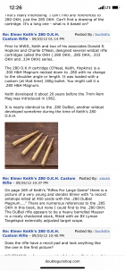

I did some searching and found out that the Dubiel and O.K.H. cartridges are very similar, and that your rifle is (likely) pictured on page 269 in Elmer Keith’s book “Rifles for Large Game”

Interesting reference.. I have the 1936 Book Big Game Rifles and Cartridges by Keith that was published by Thomas G. Samworth Small-Arms Technical publishing Company of Plantersville, South Carolina. Book is 4 1/2" by 7 1/2" and shows Keith on page 24 with his best antelope. Caption states it was killed with the 280 Dubiel Magnum. He discussed two different rifles, the one was a 280 OKH, O'Neill, Keith, and Haskins. IIRC, that one was the 30-06 necked down to 7mm. The Magnum was on the 300 H&H Magnum. Funny with the proliferation of 30 caliber Magnums, my 1951 OM 70 is just roll marked 300 Magnum. 180gr bullet at about 3000fps, dating back to 1925. We have come far in 99 years...
It is fascinating to see that Keith had a full mustache. The antelope pictured had horns over 17" and very wide spread. This is most likely the rifle I held at his home in Salmon about 1978 or '79.
