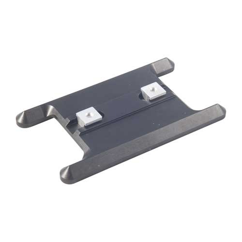

Last range trip I mounted a 3” adapter and shot off a rest, 2nd best 5 shot group for me at 300 yards, 0.47”. Looks like it’s me as the problem.
What do you mean a 3” adapter? Thanks
