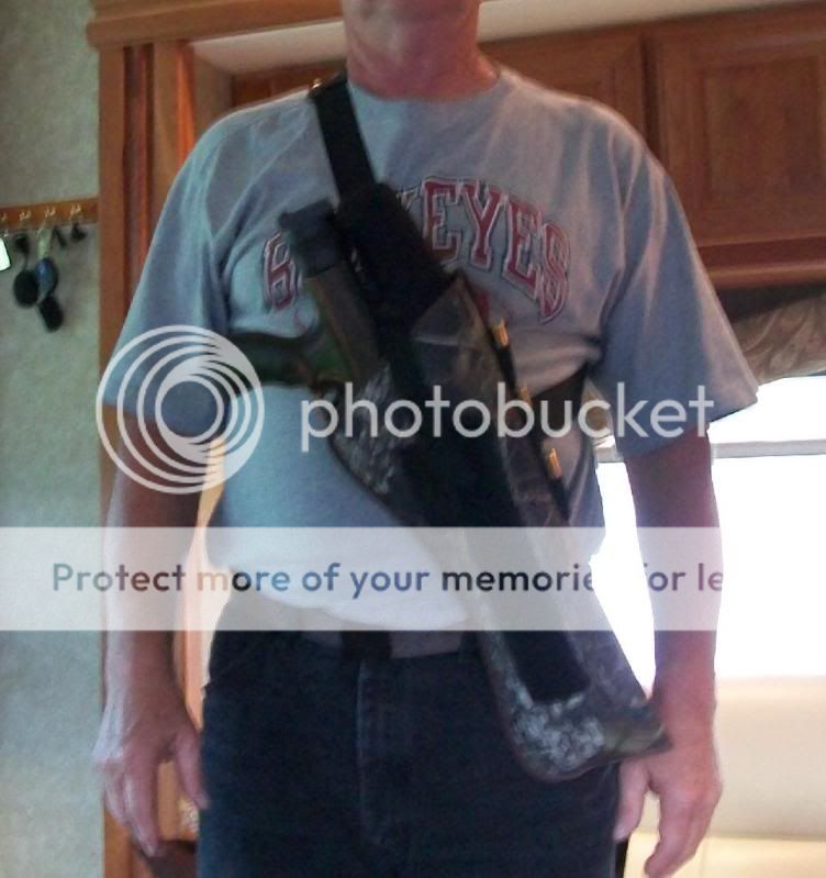

BTW, I'm selling my Competitor Corp 22-250. 9 twist 18" barrel. I've hit a one foot square steel plate at 700 yards and killed groundhogs at 400 yards with it. 64 Bergers. Just in case you might be interested. Here's a pic.

Wayne, it is made by Competitor Corp in New Hampshire. http://www.competitor-pistol.com/ It is a rotary cannon action. Overall length is 20.25" including muzzle brake and the barrel is 18". It is a lot of fun to shoot. Yes, I shoot it with the wedge under the grip to adjust elevation of the shot. Recoil is mild with the muzzle rising about an inch when shot. I enjoy shooting it but need to sell it so I can fund a scope upgrade. I'm asking $800 for the gun, scope base and holster. Add $225 to have Weaver 6.5-20 scope with Burris Signature rings included.
BTW, there are 5 pages of calibers (barrels) available from Competitor for $195 each.
