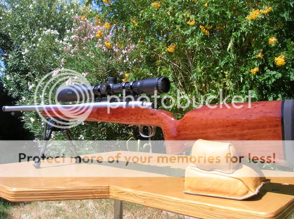

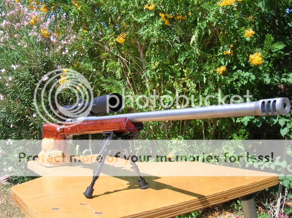

I sent Joel Russo a piece of Ironwood that he made into his A 5 stock for my 338 Ultra mag. I bedded and finished it myself using automotive clear. I bought a cheap apray gun for 39.00 and some 2 part auto clear. I will look for my pics and post them. I was going to post a link to my thread on LRH but they lost me on there some how, I need to get back with Len and get it straightened out.

You can do the clear coat your self. You can't mess it up, you just sand it and buff it out. Get a clear coat with high solids. Some 2 parts that are quick drying don't dry very hard and are sticky in the bags, then you have to use stock tape. Lay 3 coats on, sand if off to the wood, lay 3 more coats on, sand it back down to wood, now lay 3 more coats on and you should have a nice coat, if the grain sucks the clear in again, sand and repeat until the grain is sealed. PM me if you need help.
