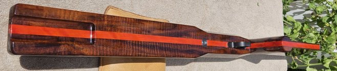

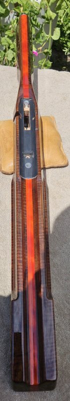

I’ve been looking at getting a wood stock that has the colored epoxy/carbon fill. I see three options (Cerus, Southwest Actions Works, and A&S - Andrea Santacroce). All look beautiful online but I’m looking for advice from people that have seen them in person and shot them. Is there a reason other then lead time to go with one over the others. Leaning torward the SW or AS. Open to other similar options too… and post pics if you got em.
I have a Cerus XR and two AS stocks. The AS certainly took some inspiration from Cerus in my opinion, but the dimenesions are little different - both feel a little different in the hand. I give the edge to the Cerus in terms of feel and I believe Will simply has access to the best quality timber out there. I'd love another Cerus but getting a hold of Will is incredibly difficult, even moreso when you're on the other side of the world.
You can't go wrong with any of them though to be honest.

Of your 3 given choices @Southwest Action Works Dennis is a great guy and makes a amazing product, great to work with great lead times for what your ordering. American made!!
Cerus, we all can agree Will makes a beautiful stock. American made!!
Not a live edge epoxy stock, but look amazing with a candy finish
@Jason Avila, American made!!
I know Jason has been playing with lumber but don't know how far he is from production
Xring Jason Pulvermacher makes a great stock also, great guy and easy to work with. American made!!
I just noticed your in Wisconsin as well
AS if your after more immediate satisfaction and don't mind sending your hard earned $$$ overseas
I appreciate the feedback. Great to hear from people that have handled more than one of the options. Was leaning in the direction of going SouthWest so glad to see positive response confirming that.
