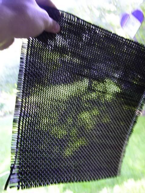

I didn't have a rotary cutter,which would have been alot better) but cutting like this, with a simple board and,new) razor blade worked. I just had to cut fast so the blade wouldn't pull fibers.
Bad photo, but it shows how loosely woven and stiff the 12.3-oz fiber is. You can easily see through it and it's not folding over like normal fabric.

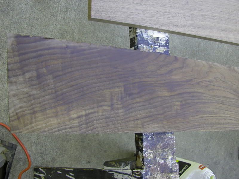

This is the barreled action sitting on top of the wood to be used before I laminated everything.
P.S. paid $3.50 board/ft. for this wood :)
I laid everything out so the best figure should wind up in the butt of the stock.

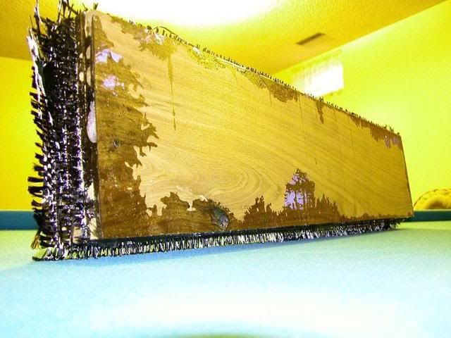

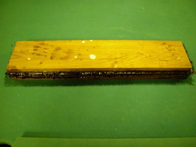

Here's the blank itself, complete with an epoxy handprint.
This shows how I cut the carbon fiber a little big so all of the edges will be uniform once I cut the blank.

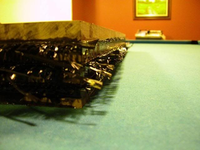

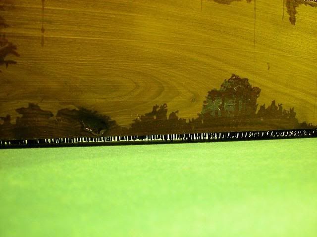

Here's the thing that blew my mind as far as how stiff the carbon fiber is... the fibers sticking out of the edges of the blank weren't completely saturated in epoxy but they felt pretty solid anyways. The blank is decently heavy... I didn't weigh it but it has some heft to it, maybe 15-20 lbs. to estimate.
Check this out... the loose fibers sticking out of the edge of the blank are strong enough to hold the entire thing up by itself.
Nothing is touching it... seriously... here's another look.
I'm looking forward to cutting and shaping it. I think I'm going to trim down the loose fibers along the edge with a bandsaw and then plane down the edges so everything is square and true. There is quite a bit of epoxy that spilled down the edges and on the bottom side but I'm not concerned about it. I'll plane what is on the edges off and will sand out the epoxy on the bottom side if it is a problem. It looks sloppy now but all it needs is some cutting to clean it right up. The most beautiful walnut stocks must have looked pretty sloppy sitting in a tree too, right?
I realize my methods probably aren't optimal for maximum stiffness but I just wanted to try something new and if anything I'll end up with a stock stiffer than if I had done nothing.

A trick to cutting straight weave like that with scissors is to pull 1 strand out giving you a guide to cut it straight.
if you need to wrap a 90 deg turn you can also pull a strand out to help make the bend and lay flat especially with heavier mesh.
