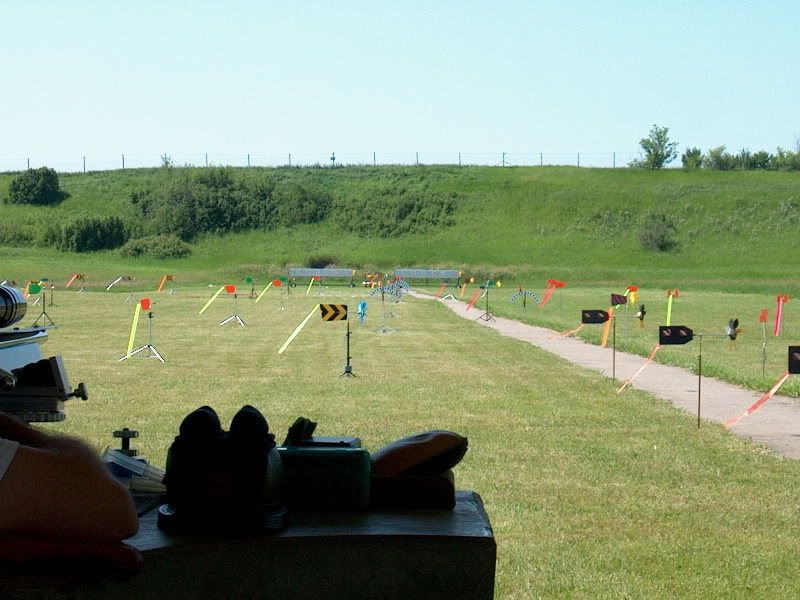

Part of using wind flags is knowing when to change-up and why. I have 83 wind flags and 30+ stands and poles. I have one particular style, flag forward, 30 flags that I could use if I chose to cover all the benches we shoot at the Nationals. But I normally use my paddle vanes, I have 12 of these. I have both 5/32 and 1/4 poles and stands and all the sleeves to convert everything to 1/4 flags. The rest of my flags are 3 types which I call blades. My stands are Sinclair and my poles are made by the guy who made all my flags, Kurt von Epp.
For vane colors I have orange/black, yellow/blue, yellow/black, orange/green, blue/white. For flagging I have 5 colors that I use depending on background and what the other guys use. I want to use the opposite colors as the guys around me. I use surveyor flagging.
I usually carry stands and poles I am going use that day in a 32" metal carpenters box. Complete with nails for tie downs, swivels, sleeves, body hammer, pole studs, slammers, tools, and spare parts.

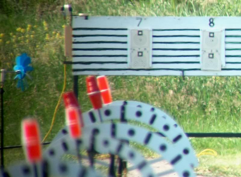

All right, now this thread has moved beyond flags. Pics really do add to the thread. Wind probes are becoming more and more popular so I guess we need some input on whose making and using them. Gene Beggs is known as the wind probe guy and his probes are seen at all the matches I attend. Locally, another shooter makes a probe similar to the one Gene makes. I've never used probes so I can't say I like one better than the other. Who else out there is making probes? How many shooters out there feel that probes add greatly to their wind reading ability?
I shoot with people that use probes of all makes and designs. Sometimes they've been very helpful for me..and sometimes not. My observations over the past two seasons is that the more 'angular' the wind is as it comes across the range, the less I can rely on the probes.
There are times when the standard flags I have in front of me show the condition I want, but a probe-type gizmo will be in a completely different position than where it was when I shot in identical 'flag' conditions. For example..my condition was:
-Wind r-l
-Flags at 5:00
-Tails at 45 degrees
-Probe pointer at second black mark
Now, if the flags and tails all line up and I see that the probe pointer is at the fourth black mark....or somewhere way off from the original 'reference' mark,the second mark), I get pretty cautious and either put one in the sighter to verify or wait until things stabilize a bit..even if it means waiting out a complete wind 'cycle', if that's what it takes.
Knowing when not to shoot can sometimes be better than the other side of the coin. And that's where a probe can sometimes help you put the pancakes on the table. :thumb:
And sometimes not. :,
The real trick in BR is to sort out all those things in a constantly-changing dynamic environment and in a relatively short amount of time.

At 100 yards I use three sorta standard flags set out under the bullet path. I also have three probe clones,home made) set out in a straight line but about three feet to the left of my bullet path. The flags are at 25, 50 and 75 yards. The probe clones are at 13, 38 and 63 yards. The probes give me a bit of information as to what the wind is doing between the flags, but I keep most of my attention on what the flags and flag tails are doing and just glance at the probes for a "Don't Shoot Now" indicator. In other words, if my flags say shoot but one of the probes is bouncing off of the ground I'll hold my fire till the probes agree with the flags. This tends to be a lot of information for your brain to process but I do try.
At 200 yards I'll add a set of flags and probes and will spread the flags and probes to cover out to 150 yards. Past that I try to use the mirage as my wind indicator. More information to process, geeeeze.

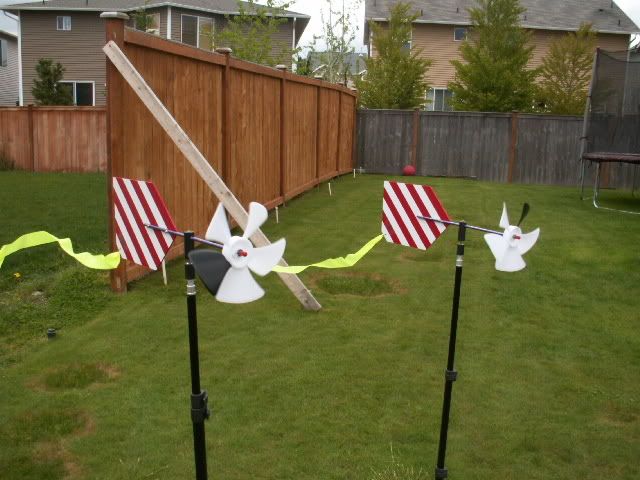

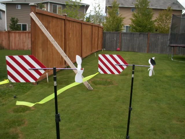

There are some really nice features on the Carbon River Windflags that Michael Gibeault is making up in Washington.
www.CarbonRiverWindflags.com
The shafts are light but stiff anodized aluminum, and he's got a slick system to reduce drag--the pivots employ opposing magnets.
The spinners are quick-detachable:
Paul
Great looking flag attachments. Like to see the whole flag on the poles in action. Like the design on the propellors. He lives in any area to put them to good use.
