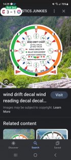

I'm looking for a wins drift card I can take with me to the range for practice.
Found this one but didn't know if there was another place to get buy one

First of all it’s wrong. It calls out a 45 deg wind as “half value”, when in fact, a 45 degree is actually 70.7% value and not 50%.
COS 45 = .707
Half value winds are winds from 1,5, 7, and 11 O’clock
