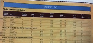

From a ‘94 catalog. 1:14 twist 513FD5ED-529B-4E1F-A048-56474BB66886.jpeg
ETA. The one pictured in the catalog is a non fluted stainless barrel.
