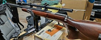

To answer the OPs question, it all depends. All my 52s except my D have a barrel band. My pre A, A (AL Freeland rifle), B and C all shoot very well. The D edges them with a better trigger and currently wears a tuner. Take the tuner off and they all are about equal IMO with the Freeland getting an edge. The pre A is probably the most consistent, she doesn't shoot overly large nor are true single hole groups the norm...just nice round groups from the old gal.
Your mileage will vary, obviously now no one's using a barrel band for accuracy but don't rule out using a pressure pad for it. I've seen it work, these rifles shoot very well especially against rifles of their time, 40x's, kimber 82s, 37s etc. Don't expect to win against full blown customs but it amazes me the groups guy were shooting with these rifles during those times with the ammo they had.
My 82G can usually outshoot any of my 52s or 40x with iron sights but they all are very close.
Attached are my 52s...notice the bands
