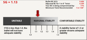

Here is the estimate from the Berger Stability Calculator at 8 twist
And here it is at 7 twist.
It doesn't have a jacket to blow up, so I would ring them and see what they have done with it in 22 Creedmoor before I invested in a barrel for such a long bullet. I think if you only shoot at altitude, you would get by, but if you shoot near sea level, I would double check with them.
